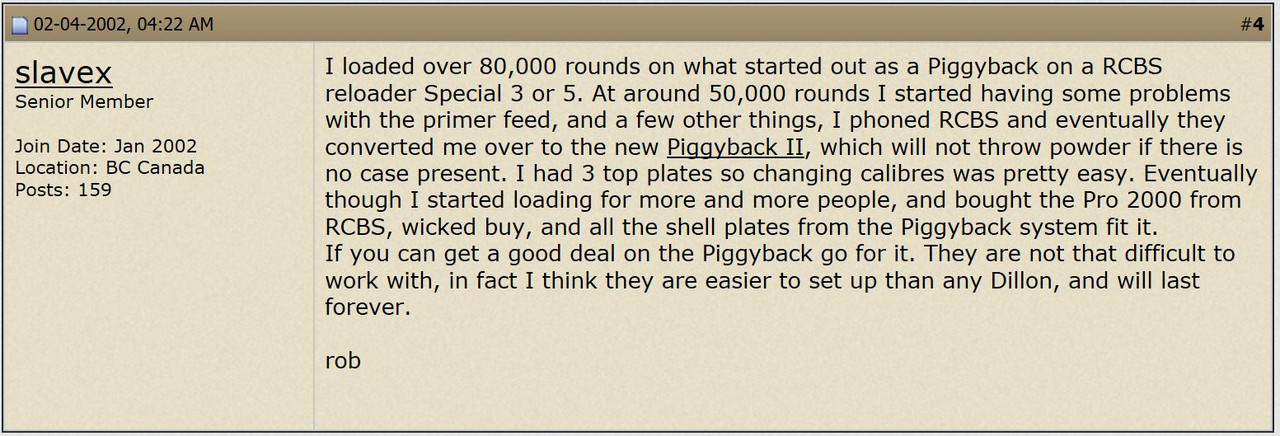

If you own an RCBS Rock Chucker, look into the Piggyback II (no longer made and not commonly on the market). It is an add-on Progressive to the RC. I reload all of my pistol and revolver ammo on the PBII. I forego the temperamental auto primer on the PBII and instead use the Universal Primer on the side in bulk case priming sessions. I added a powder indicator die and also crimp cases at the same time as loading the bullet on the PBII. Here is a 2002 testimonial:

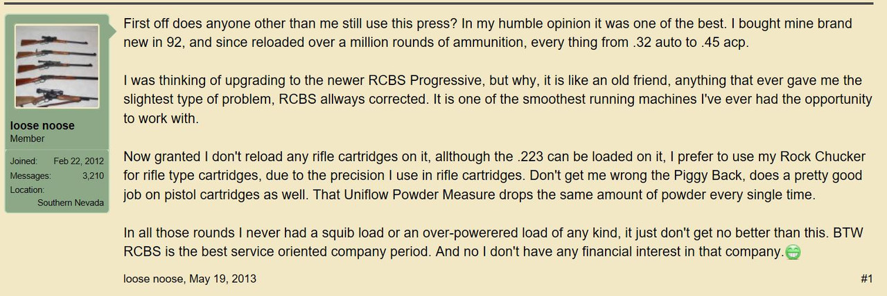

another in 2006:

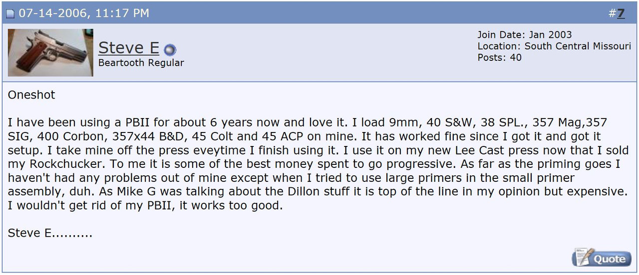

and a final in 2013:
