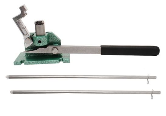

You can get an Automatic RCBS Bench Priming Tool delivered from Amazon for $95.00 (Amazon link above). There is nothing "automatic" about the manual "throw", only the 100-primer tube feeders and its action of moving into and out of the shell holder. If you don't already have the RCBS (or compatible) shell holders, this might be a Bridge Too Far.
Mine works great with a modification, the addition of a spring return between the shell holder and the lever arm. It is not difficult (for me) to press down against the return spring.
I can think of mounting the modified (return spring) Primer to the bench and adding a foot pedal for the down swing. Food for thought...
